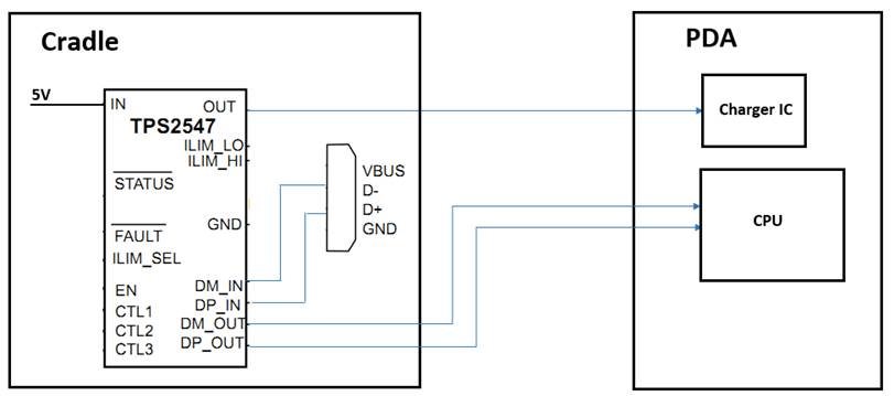

Customer is developing Cradle for PDA.
TPS2547 is under review for application to Cradle.
The customer wants to configure as shown in the figure below.
Could this section need to be modified?
Looking forwad to your prompt reply

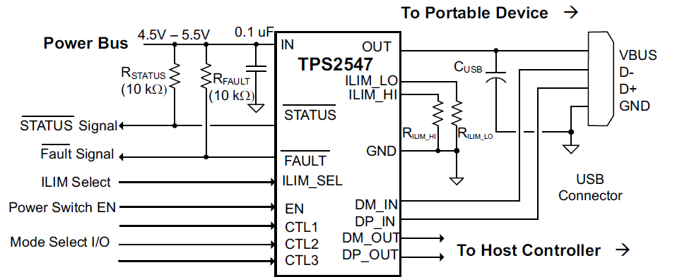

  • Hello Kim,
    The OUT pin of the TPS2546 should be tied to VBUS of the USB connector, instead of connecting it to the charger IC. I Would recommend following the below schematic as this is how the TPS2546 is designed to operate.

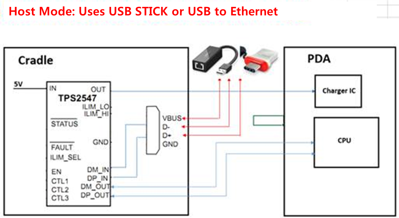

  • Good morning
    thank you for your quick reply.
    In addition, we will contact you with the following specifications.
    1. Please check if Host Mode Case or Client Mode Case below is supported.
       A. Host Mode Case: PDA connected to Cradle should be operated as Host.
       B. Client Mode Case: PAD connected to Cradle must be operated as Client.
