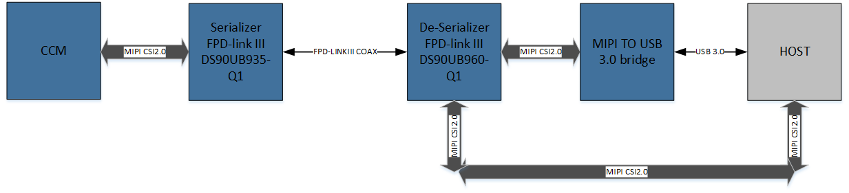

our topology on our board will look like :
The plan to use the replicate mode of the 960 to duplicate the camera input and to bridge one of the channels to USB
is this topology viable?
do you have better candidates to suggest for the components?
can we add multiple devices on the I2C on the serializer side? what are the limitation other then the delay the BCC might cause?
  • Hello-
    Yes, the topology is viable. The IC selection is also good. The DS90UB954-Q1 is a possibility, too, however, in replicate mode, it can only support up to two CSI-2 lanes per port while the DS90UB960-Q1 supports up to 4 lanes for each CSI-2 port.
    You can add up to 8 I2C slaves on the serializer side. This is limited by the number of SlaveAlias
    and SlaveID register pairs available on the deserializer.
    Davor
