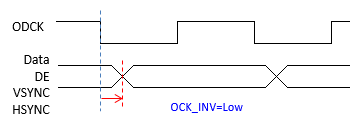

Is there required max hold time(th1 and th2) for TFP401?
I think that if hold time is too long, it will any influence to data signal.

    If hold time set extremely long time, is it also no problem operation?
    Background is customer comparing TFP401 and Competitor(SII1161).
    TFP401 is not described below timing specification; "ODCK-high or low" to "Data-high or low"
    I calculated min value.
    But max value is not calculated because I didn't judge it is correct to use min hold time on max value calculation.

    Datasheet P18 is described below equation;
    ※Todck = 148.5MHz, Tduty = 40%~60%, ODCK FallingEdge condition
    Customer want to know TFP401's Tck2out (Clock-to-Output Timing) spec.
    But calculation result are Tck2out(max) = 0.836 ns and Tck2out(min) = -2.0936 ns, we feel that Tck2out(max) is too short time.
    Can TFP401 apply same as above equation?
    Or, is there spec for TFP401's Tck2out(max)?
    Satoshi

    I'm not sure about that equation since the TFP401 does not have a "Tck2out" specification, so I don't believe that equation can be applied. The setup/hold times for falling edge conditions are listed on page 8 of the TFP401 datasheet.
