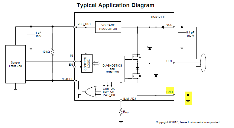

The TIOS101 has pins 9, 8, and 7 which are for the sensor connections from the MOSFETs: VCC (24v), OUT, and GND.  The GND connection is shown as connected to the system ground in the application diagram (outside the chip), but does it need to be?  Ground for the chip is through the thermal pad.  Is there a connection between chip ground and GND pin 7, or are these isolated?
  • Hi David,
    Pin 7 is indeed connected to the chip ground internally - it is not isolated. The connection through the thermal pad is actually not a very strong electrical connection (the pad is primarily present to aid in thermal coupling) and so the ground pin is needed.
    Max
