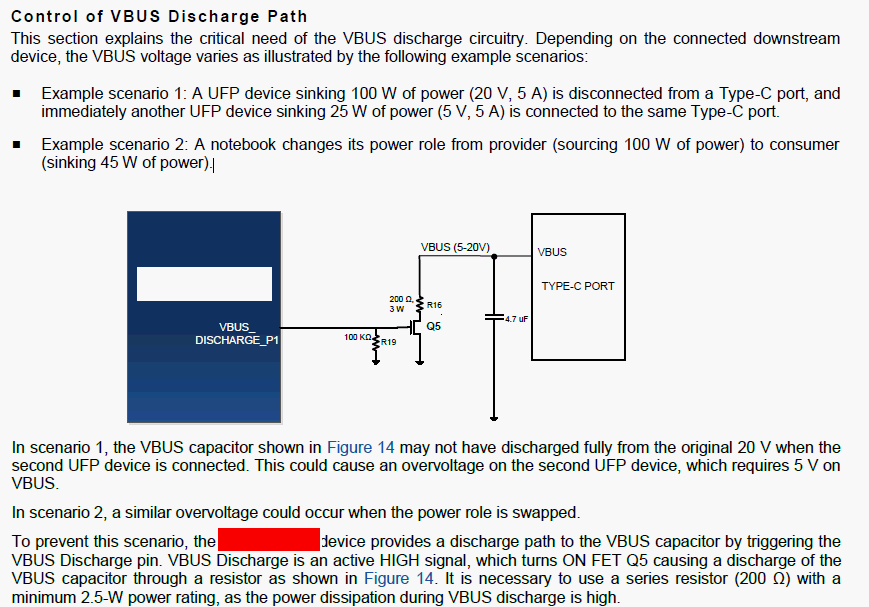

May we know how does TPS65987 do to achieve the purpose as described below?  THanks!
