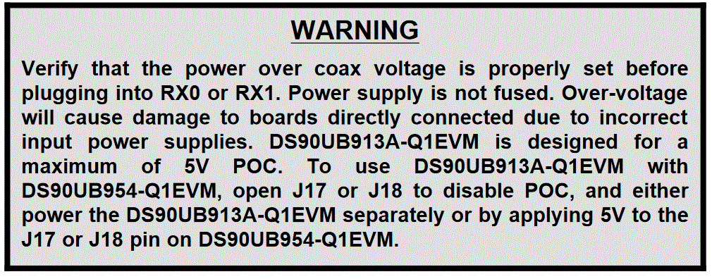

Dear support team;
I want connect DS90UB913-Q1EVM and DS90UB954-Q1EVM.
I confirmed the following description.
I opened J17 and J18 on the DS90UB954-Q1EVM.
When I supply 12V via JP11 on the DS90UB913-Q1EVM, the device(DS90UB913) is warm.
When I supply 5V via JP4 on the DS90UB913-Q1EVM, the device(DS90UB913) is not warm.
Which is correct?
