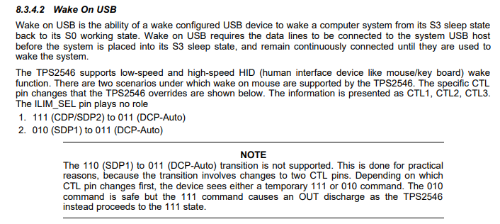

  • Randy,
    Here is the relevant section of the specification.
    The DSP1 to DCP-Auto transition is specifically called out as not supported.
    The two transitions that are supported for wakeup are:
    1. 111 (CDP/SDP2) to 011 (DCP-Auto)
    2. 010 (SDP1) to 011 (DCP-Auto)

  • The 111 (CDP//SDP2) to 011 (DCP-Auto) is a supported wakeup. It is only the 110 (SDP1) to 011(DCP-Auto) that is not supported.
    From what you have described, your system should function correctly.
