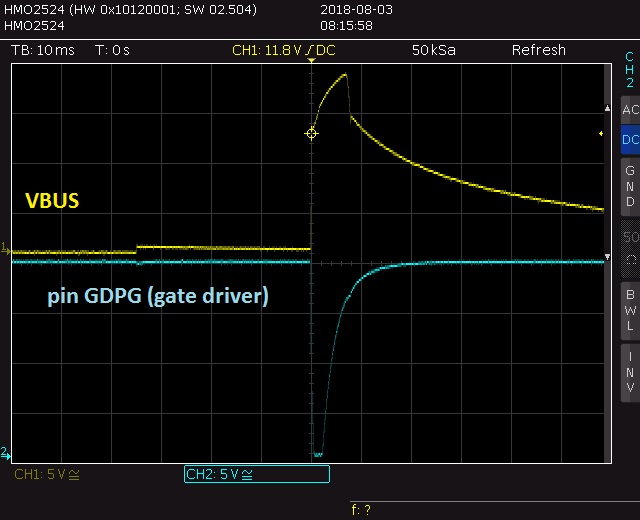

We have our own hardware with the circuit as discribed in Typical Application, data sheet §9.2 "A/C Multiplexing Power Source". We only have 20V instead of 12V. When we attach a USB-C device we see a 10ms long 20V pulse. The voltage then decreases to 0V before rising to 5V. We measure at pin GDPG (gate driver of 20V P-FET) an see a short low level pulse (0V) which enables the 20V FETs. This is long before any communication on CC line starts, it is immediately after connecting the device. Same behaviour is when we only simulate a detach / attach by removing the CC-pull down on the slave. When the resistor is reconnected the 20V pulse appiears.

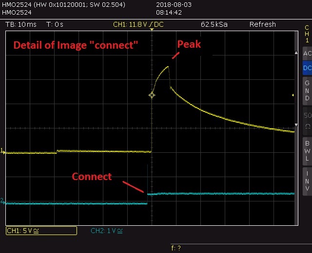

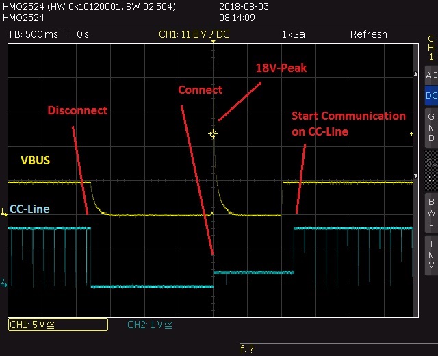

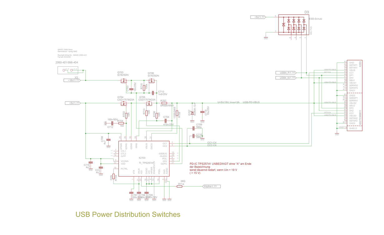

    yes, as you see in the capture below the peak comes immediately when we connect the USB-C slave. The picture below with 500ms/div. shows what happens when I disconnect the USB-C cable and reconnect it. I have also attached a detailed capture and a capture of the gate voltage at pin GDPC and the schematic.

    I did not notice anything abnormal about your schematic. The only thing that I did notice is the connection to GD. I cannot see where that connection is going, but make sure that pin is pulled high.

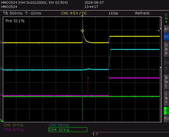

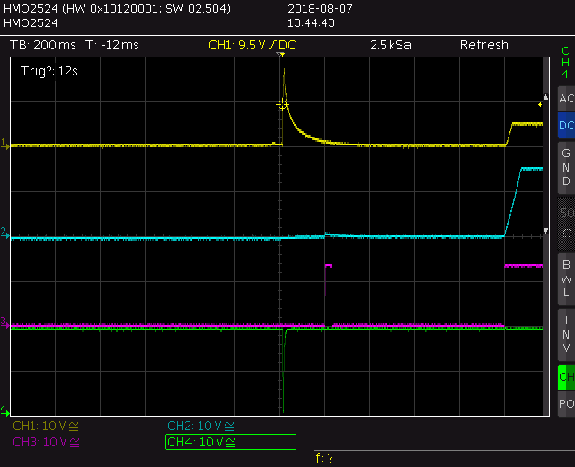

    attached are the screenshots (second is only zoomed).  VBUS (yellow), GDNG (blue), G5V (red), and GDPG (green)
