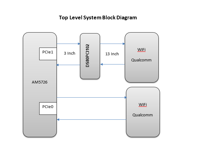

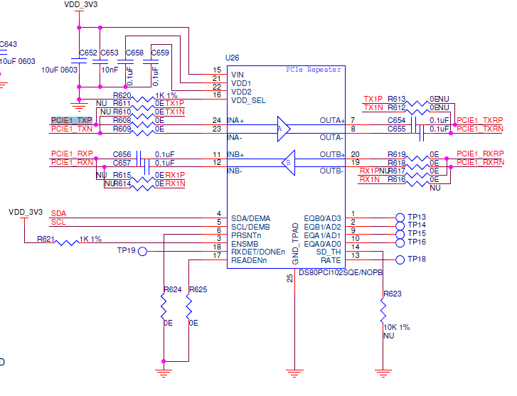

I am using the TI repeater (DS80PCI102SQE/NOPB) between PCIE2 and WiFi Qualcomm Aetheros module. is there require any default setting?
AM5726 have two PCIe lane and Lane2 has connected to repeater (DS80PCI102SQE/NOPB). is there require driver for repeater and register setting to enable it?
