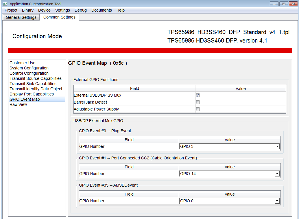

My customer is designing TPS65986 with Application Customization Tool version 4.01.
Project -> New Project -> TPS65986 -> Standard (Recommended) -> DFP only
GPIO Event Map in Common Settings shows the folowing.
Is there any way to set push-pull output for any GPIOx?
Is it required to select "Advanced " in selecting project as the following?
Project -> New Project -> TPS65986 -> Advanced -> DFP only
Yaita / Japan disty
  • Hi Yaita-san,
    The default behavior of our GPIOs is push-pull. In the Advanced templates you have the option of adding the internal pull-up, pull-down, or to set the open-drain output. This is typically not needed. If you use the standard template, your GPIOs will all be push-pull

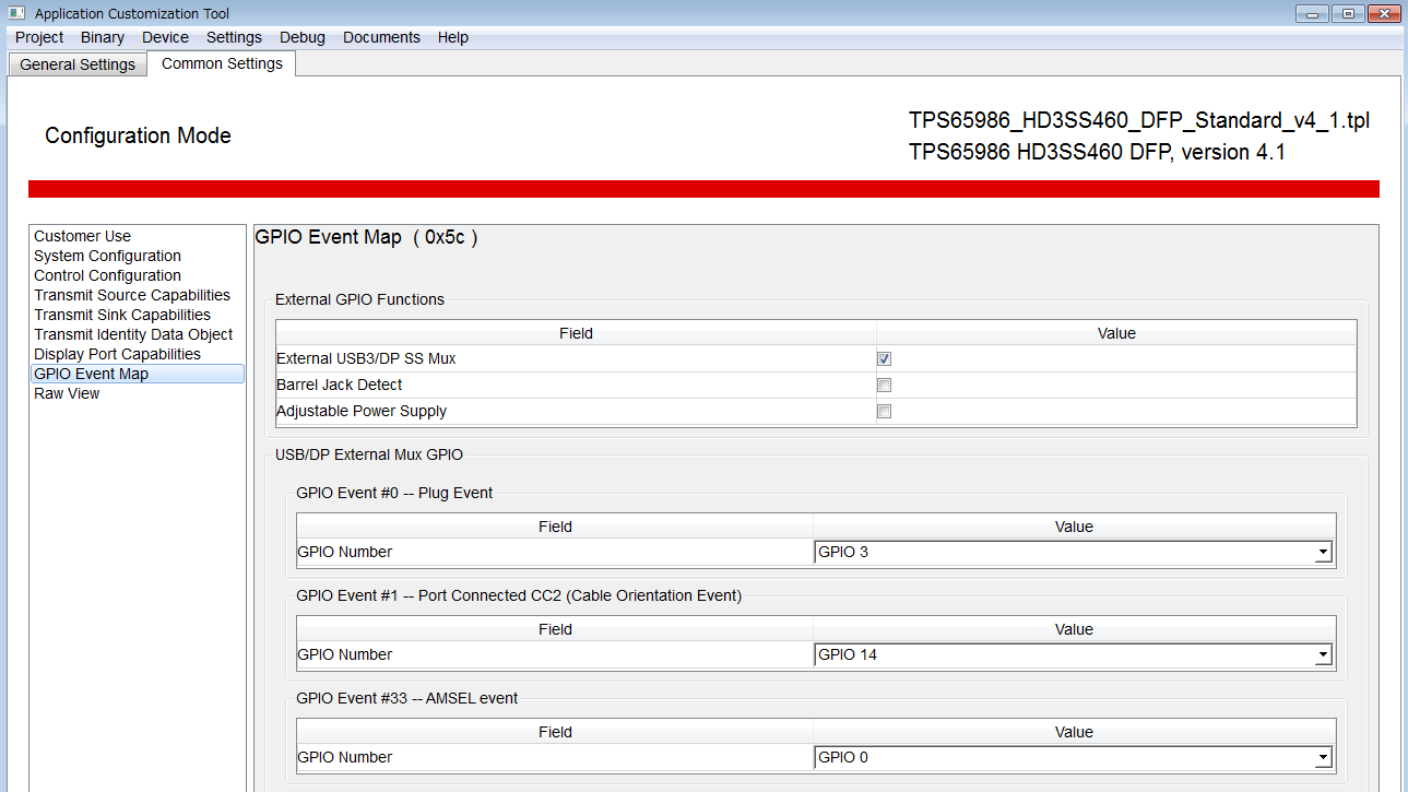

    I think my question is not clear, so let me ask more specific.
    The following screen shows "GPIO Event Map" in standard template.
    If we don't change the setting above, I believe GPIO1 is "push-pull" as you refered.
    1)
    Does GPIO1 outputs low level after power-on(POR) in this case?
    2)
    If my customer don't use GPIO1, should he set GPIO1 to leave floating (not connected) in this case?
    Or should he put 1M ohm pull-down resistor?
    Yaita / Japan disty
  • Hi Yaita-san,
    1. The GPIOs would output low if they are unused.
    2. It is recommended in the datasheet to use a 1M pull-down resistor on GPIO1 if it is unused.
