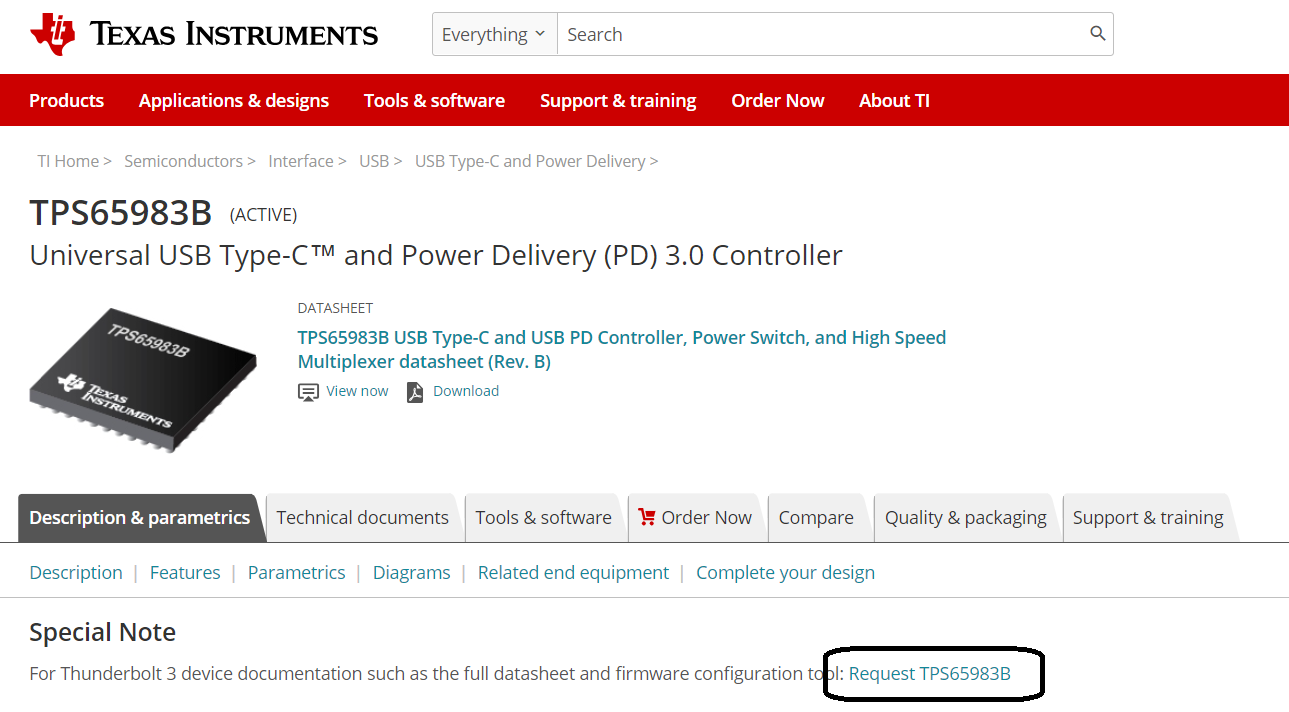

My customer use TPS65983B (Thunderbolt3) and can not search the FW in ti web。Can you provide the FW to me。
Hi Smith,
I am not sure what you mean by "cannot be detected".
However, you can use "TPS65983B MM HI Application Customization Tool" to download the firmware bin to the SPI flash. Use the flash App Firmware to Device option, for more details refer the tool user guide.
