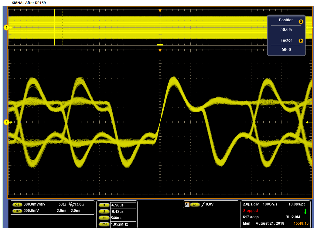

  • hi Malik,
    for the 2nd issue,  (4 lane change to 2 lane), customer test the jitter before and after DP159, the result is as attached, and waveform as below, pls help check whether they need change the EQ setting.  https://e2e.ti.com/cfs-file/__key/communityserver-discussions-components-files/138/jitter-result.7z
  • Vera
    Looking at the signal output of DP159, it looks like the signal is over-compensated. What are your EQ and de-emphasis/pre-emphasis settings? I would try to reduce them first.

  • hi David,
    double checked with customer, they did not set any eq in the link: 0ch bit [1,0] is 00, and 0dh bit [5;3]  is 000,  AUX_src is used as CLK output.  so what's the possible cause for the lane  number change and the over compensate? tks!
  • Vera
    For the output measurement of DP159, where do they measure the waveform?
    If they change bit [1:0] of address 0x0Ch and bit [5:3] of address 0x0Dh, are they seeing changes in the waveform? I want to make sure DP159 is being properly controlled.
    Without looking at the link training log file, I can only speculate that when link training failed at 4 lanes, the source changed the lane count down to 2, and start the link training again.

  • hi David,
    AUX bus is used for recvered clk out and send for FPGA as reference. the EQ setting and pre-emphasis is all default value. (i.e. no equalization), while the output waveform seems be over -compensated.
    customer test the output at both DP159 output and FPGA input, the waveform is similar.
    they found when changind the reg of 0x0c and 0x0d to set the eq, there is no changing in the waveform, and the read out of 0x0c bit [1:0] is always 0, nothing changed.
    so is there other reg need be set for setting the eq? what's the possible cause for the over -compensation? tks!

  • Hi David,
    No , the 4 lane to 2 lane issue is closed, while the over compensation issue is not yet. Pls help check why the 0x 0c and 0x0d seems could not control the eq well as descript in my previous email. Tks !
  • Vera
    1. Customer is using DP159 as a DP retimer, so EQ programming is not done through Page 0 register. EQ programming is done through Page 1 register. Please refer to app note SLLA358.pdf, section 4 on how to access Page 1 and TX and RX configuration.

    2. It is better to change the TX SWING level from min to max level as it is easier to be observed on the scope to make sure you have full I2C control over RX and TX control register.
    3. The over-compensation you saw in the measured waveform could come from reflection. The way to measure the DisplayPort signal is to measure the signal at the end of transmission line. So the ideal way to measure the DP signal would be
    a. Remove the AC coupling cap between DP159 and FPGA (break the link between DP159 and FPGA so the measurement is not impacted by possible reflection)
    b. Have the AC coupling cap on the scope, and assume signal line is being terminated inside the scope, do the measurement
    David
