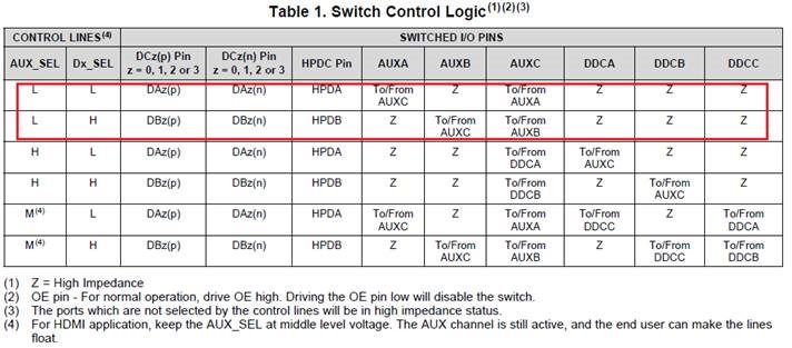

Hi Team,
My customer wants to switch the HDMI signal with our HD3SS215 but they are only going to switch the data lines, i.e. the DCz(p) and DCz(n) pins.
In this case, which control logic in Table 1 should they choose?
We think it should be either of the 2 upper ones (so that the DDC bus is open) but the datasheet suggests that the AUX_SEL should be kept at middle level voltage for HDMI application.
Could you please comment?
Thanks!
