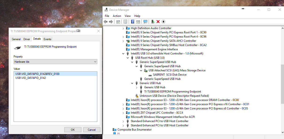

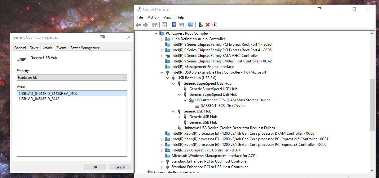

I received the EEPROM for the TUSB8041RGEVM Board  REVD 6556574. The TI programmer appears to work fine, as seen on these screenshots.
My problem is that the data does NOT appear in Device Manager, even after a restart. Yes, I replaced the driver and put SDA/SCL back to normal positions before restarting the computer. I even turned the device on and off afterwards, still nothing.
Screenshot Showing Programming Configuration
Screenshot Showing After Programming (USB 2.0):
Screenshot After Programming Super Speed:
Just to make it easier on myself, I changed the VID to 0351 (as opposed to 0451) and the Product ID to 8042 (as opposed to 8142). I changed the Manufacturer and Product description, but nothing shows. There was a brief attempt, when I did not see the strings show up, but I did see the VID/PID show, but that is gone.

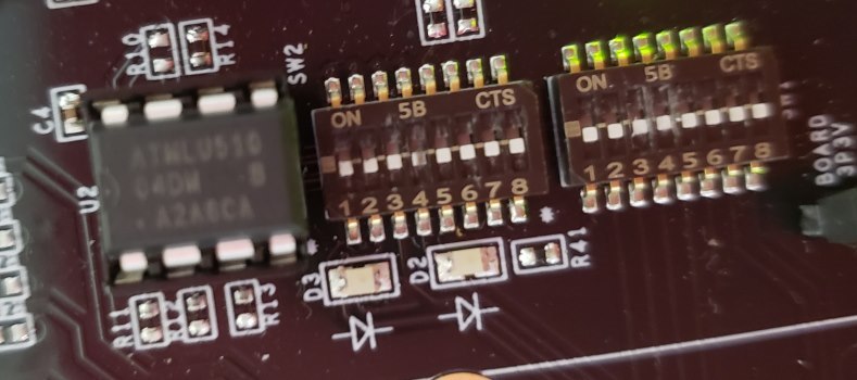

    As noted earlier, SW1_3 and SW1_4 must be on to enable the pullups to SDA and SCL or the EEPROM access will not work.
    After programming the EEPROM, the EVM must be power cycled.
    JMMN

    I did not realize that the 2 switches must be pulled up all the time for the chip to recognize the EEPROM. I thought that was just for programming.

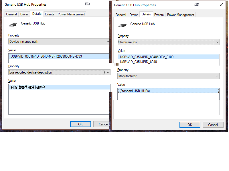

    I see the VID/PID, as you can see from the screenshot below, however the manufacturer name and name at the top (Generic USB Hub) still says that. There is one field, which is in an Asian looking language. Is that the product description? If so, what is wrong and why not "DittoDrive"?

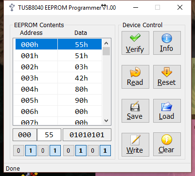

  • By the way, the first screenshot at the top shows 0x55 at location 0x00. Any custom changes would be in red.

  • Solution:
    1. Product String = "Bus Reported Product Description"
    a) That means that it is not possible to change "Generic USB Hub" and "Generic SuperSpeed USB Hub".
    b) My Asian looking characters were because I had MSB and LSB swapped in the characters.
    2. I can successfully change VID and PID now. Unplugging the device (or turning off) for changes to take effect. Also, as noted earlier, SCL and SDA need to be pulled up all the time.
