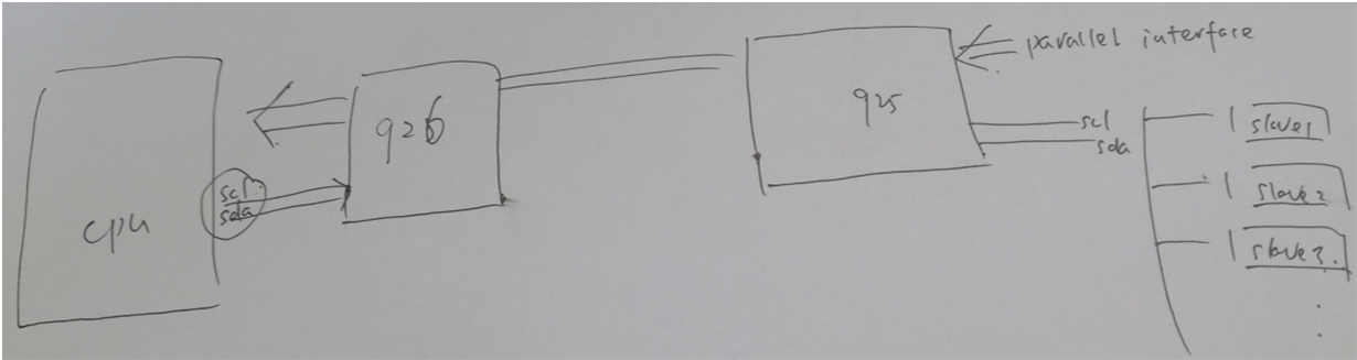

926 925 topology as below customer wants to realize cpu-i2c-926-925-i2c-slavex to configure slave, then read data back.

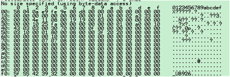

at present, customer cannot search slave through cpu. maybe the configurative issues.   the present configuration is as below:
read data from register: (why 0x1C=02?)
thanks!

    to configure the I2C link between Ser and Deser, please follow up the procedure:
    1. set the i2c pass through
    2. set the alias of the paired ser in your case, and set the remote slave I2C addr. ID, and alias ID.
    3. read/write the remote slave with alias ID.
    below is one app. note for your reference, all FPD-Link have same I2C operation procedure.
    "I2C over DS90UB913/4 FPD-Link III with Bidirectional Control Channel"
