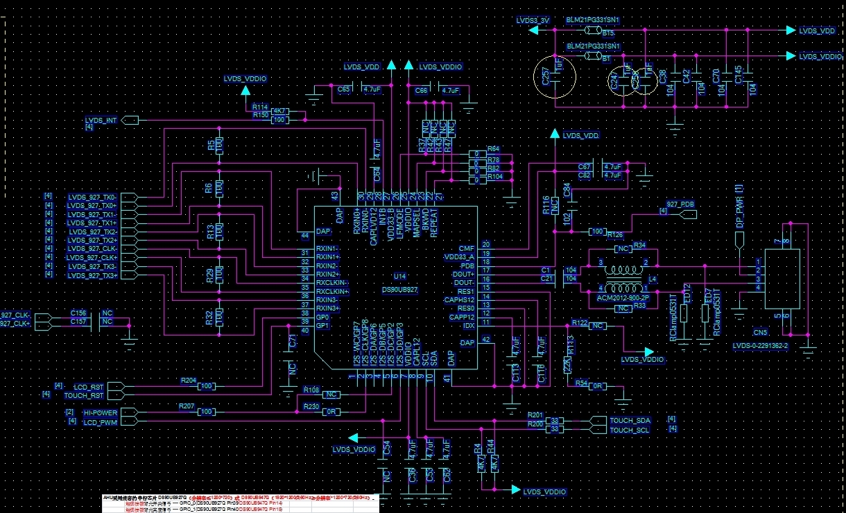

Host pass through control signal of display luminance from gpio8 of 927 to gpio8 of 926 (display end). Sometimes it failed, that is, electrical level of gpio8 has transferred from PWM to low, while gpio8 of 926 still keep high. By resetting  926, it can recover.
could please provide probable causes?
the layout is as below:
thanks!
