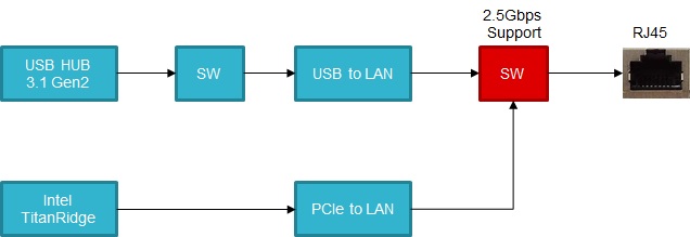

I am looking for LAN switch for 2.5Gbps.
The below is block diagram.
Can HD3SS3412 use as LAN switch supporting 2.5Gbps?
Or, if there are better solution than HD3SS3412, please inform me about the devices.

Hi Tamio,
These switches have not been designed for cabled ethernet applications. They have enough bandwidth to support 2.5G operation, but the internal series resistance and common mode voltage requirements many present a problem for LAN operation.
