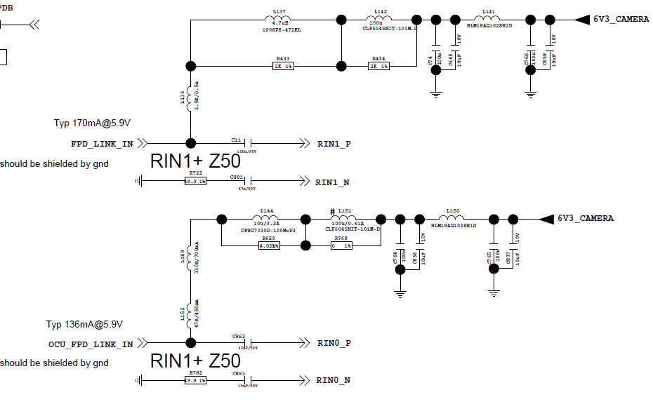

  • I don't think this is switching issue, I think it is your board setting issue. please below analysis:
    1. the issue is reported after 1s, the IC chip response time is so slow?
    2. for the setting, i check your reg., when paired with UB913a, the csi2 port lane rate is 400Mbps, you should refer to page40 of UB954 to set the correct CSI2 port timing. question: why not keep the same CSI2 port lane rate for both ub953 and UB913?
    3. if you have reset after the power-on, and have ~100ms delay, the link is becoming more robust. after reset, you should re-config the reg.
    4. does it have other noise generation in the board after the switching? which could result into CRC error.
    5. what is the PoC network design of UB954? which could result into CRC error.

    3. Our PoC design refers to the official document.(as attachment).  Hope you can help us review again.

  • 1. of course, the UB913a and UB953's work mode can not be changed. they have diff. working mode when paired with UB954.
    2. if cable has problem, the link error does NOT happen just in 1min. PoC layout and PoC component selection is important.
    3. how do you switch? you drop one camera? from the setting the serializer alias name are same. if both 913a and 953 modules are attached, please use diff. alias name.
