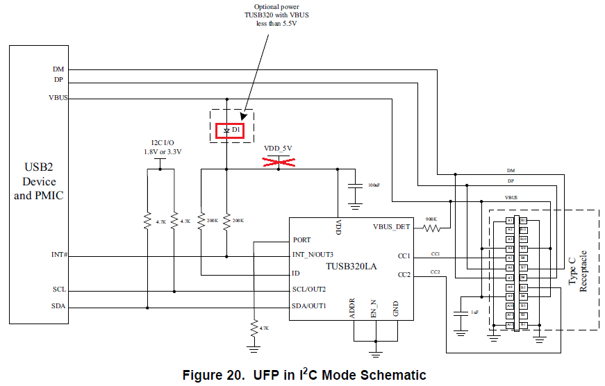

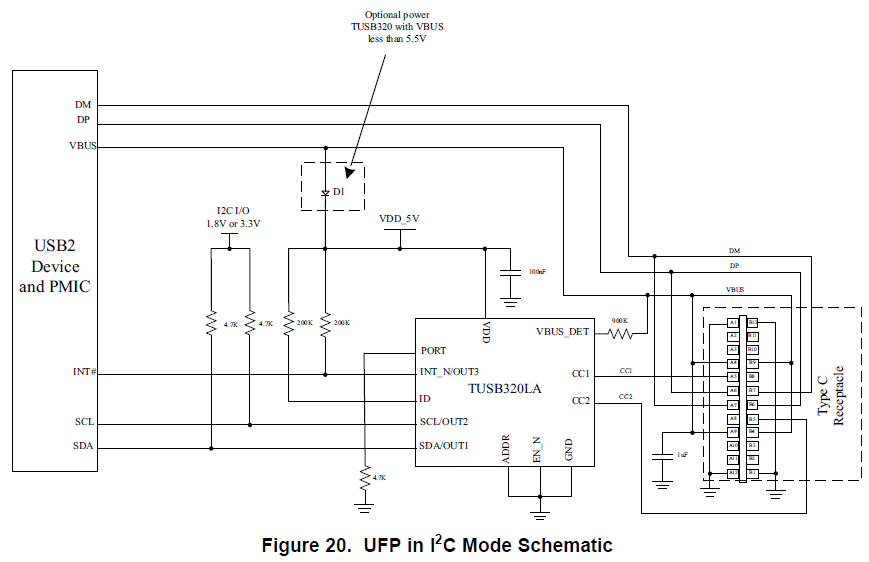

There is "UFP in I2C Mode Schematic" in datasheet however my customer wants to set GPIO Mode.
I would like to know if the following modification from Figure 20 are sufficient or not.
Could you kindly check?
- ADDR -> NC (floating)
- D1 can be eliminated if the application isn't bus-powered
- SCL/OUT2 and SDA/OUT1 can be left floating if unused
- INT_N/OUT3 can be left floating if unused
- ID pin can be left floating if unused
