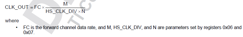

I'm using UB960 - UB953 ser/deser pairs and I have few questions:
1. In Synchronous mode forward channel rate is a fixed value of 160 × REFCLK? So, with REFCLK = 25 MHz, forward channel data rate is always 4.0 Gbps?
2. To get 25 MHz output clock, according formula:
Following values should be set: M = 1, N = 0x28 and HS_CLK_DIV = 4?
3. Is there way to check serializer output clock frequency?
