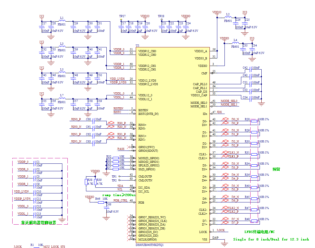

Hello TI,
May I know 948 Deserializer can support 1920*720*60fps? our boadr LVDS signal has jitter cause the screen to display an abnormality.
Could you help us to review schematic and commend for it? thanks.
    This is a system-level margin thing, so you need to make sure the PCLK quality, the power supply noise and fidelity, and the board layout are all checked thoroughly so it doesn't affect the overall system performance that can cause any display issues.
    You can use the datasheet typical application diagram and follow the guidelines and requirements to ensure your schematic meets the needs. Please keep in mind E2E is a public forum so intended to share any confidential information such as schematics.
