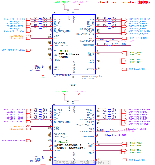

Hi Sirs,
Sorry to bother you.
Currently measuring Chip will have a high temperature (48 C at room temperature)
Could you share experience how to lower down the temperature?
1. How to design to reduce the power consumption in this IC?
Thanks!!
