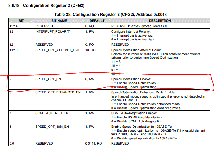

    I believe you are running into a problem called link speed optimization.
    if you connect a 1000M PHY in auto-negotiation to another 1000M PHY in auto-negotiation, using a 100M cable (only 2 twisted pairs), you will get a link at 1000M.
    The PHY's on both ends need to detect the use of 100M cable and fall back to 100M speed.  The PC is doing this OK, as it shows 100M full duplex, but the 867 does not do this automatically.
    You must enable "Speed Optimization" mode in the DP83867 to detect 100M cable presence.
    The speed optimization feature is enabled using bit[9] = 1 in the register address 0x0014.
    Once this bit is set by your driver in Linux, then the DP83867 will detect 100M cable use and show the proper link speed of 100M.

  • Hi heng,
    With speed_opt_en, the link should toggle up/down 4 times before DP83867 drops to 100M. The link will actually toggle the amount of times set in speed_opt_attempt_cnt shown in the register.
    Is this link up/down happening? Do you see LED1 toggling?
    Finally, as it seems you have an issue with not receiving auto-negotiation, lets check your RBIAS pin, and your X_I frequency.
    RBIAS pin voltage should be approximately 1V. The frequency on X_I should be 25MHz +/-50ppm.
    Please let me know the results.
    Then try to write register 0x9 = 0x0. This will disable 867 from advertising 100M mode. This should make the link go into 100M on the 867. If this is not happening, then there is some bigger problem. Please let me know the results.

  • hi heng,
    this is a common problem that will be fixed by enabling link speed optimization. This is described in datasheet section 8.4.6.6
    Speed optimization is enabled by setting bit[9] in register 0x14 = 1. This can be done in your driver, or done in uboot mode using miitool command.
