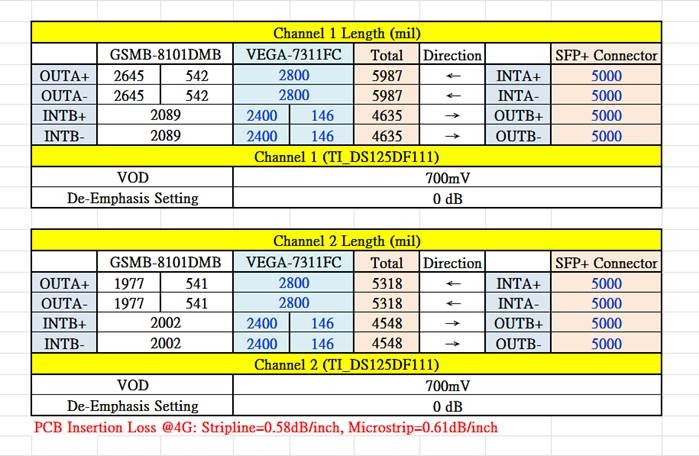

We use DS125DF111  this product needs to confirm the length problem with you. Please kindly reference on below.
Please kindly let me know if you have any suggestions. Thanks for kindly help~
GSMB-8101DMB : Main board
VEGA-7311FC : Transfer board
Example. Channel 1 (OUTA+) : CPU => 2645 mil => VIA => 542 mil => Connector =>  2800 mil => DS125DF111 => 5000 mil => SFP+ Connector. Total is 10987 mil.
  • Hi AJ,
    1). To really analyze this correctly, it would be a good idea to do a simulation using your pcb and connector S4P files. Do you have access to Keysight ADS software?
    2). Please send me email and tell us about your application. Here is my email address: nasser.mohammadi@ti.com
    3). We would like to send you DS125DF111 IBIS-AMI model so you can do this simulation.
    I am going to close this case and please send me email so we can get you this model.
