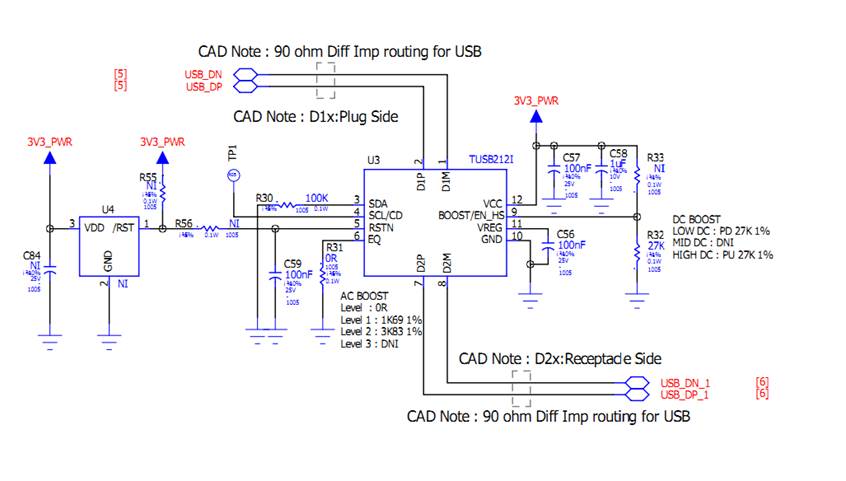

My client currently wants to apply TUSB212 to new models.
However, the following problems have occurred and I ask for confirmation.

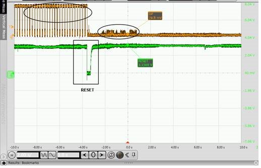

1. Symptoms:
A. USB Device mode: Normally recognized.
B. USB Host mode: Not recognized.
USB high speed does not recognize the device (USB 2.0 Memory Stick)
However, if the TUSB212 IC is forcibly reset whenever USB Memory Stick is recognized, it will be recognized.
And the Low Speed (mouse) device is recognized normally.
In addition, please review the circuit diagram below.
