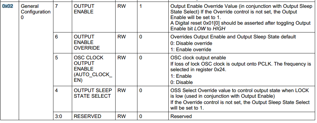

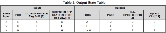

        When I am using DS90UB948, No matter I  config "OUTPUT_SLEEP_STATE_SELECT" to 1 or 0, their is normal output in LOCK and vide0.
        But according to table2 in 948's datasheet, when OUTPUT_SLEEP_STATE_SELECT is set to 0,  their will be no outout in lock and video~
Why?It's strange~
     according to the datasheet,when lock is reset, I need to register OSSS(output sleep state select) higa,and then lock will be high~
but when I test,we don't have to set OSSS to 1,when it's set to 0, Lock will also have normal output~

  • 1. Please follow up the d/s, if you think output sleep state selection has problem, I would suggest you dump up the reg. of UB948 and check whether the setting is correct or not. also, LOCK/Data are low if 0x02 is set correctly.

    I have checked the 0x02 register,when the value of 0x02 is 90(1001 0000) or 80(1000 0000),lock status is always high~it's really strange cause it's different from TABLE2 in 948's datasheet~
    You can refer to the register below   PS:0X18 is for watchdog,so it has changed ~

  • pls read d/s page50, to use reg. setting of OSSS, you should set the OUTPUT ENABLE OVERRIDE firstly. so the setting in your case is not right.

  • T^T, I change the 0x02 register to D0(1101 0000) and lock status is still high~
    I am  confused of the register 0x02,what's the relationship of bit 4/6/7 ?

  • To set 0x02[7] and 0x02[4], the 0x02[6] should be set b'1!!! for this case, the setting is 0xd0, the OE and OSS is "high", please check the output status in table2 dependent on "serial input" and PDB status.
    if you set 0x02=0x50, the Lock should be "low" based on table2.
    regards,
    Steven
  • but I set 0x02=0x50 the Lock  is  still "high"

  • The lock is pull-up or not?
  • Hello Steven,
    The 948's lock pin is connected a 0Ω resistance  and then connected to MCU~
  • Pls isolate the MCU issue by removing this 0ohms resistor, and try the diff. setting providing in the reg. to set the OSSS/OEN of UB948.
