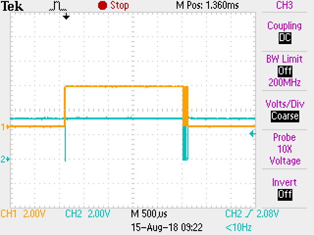

  • This appears to be a clock stretching issue. I have some oscope images that definitely show the clock stretching.
  • Hello-
    It appears to me that you have identified the root cause of your issue. Let us know if need further assistance.
    Davor

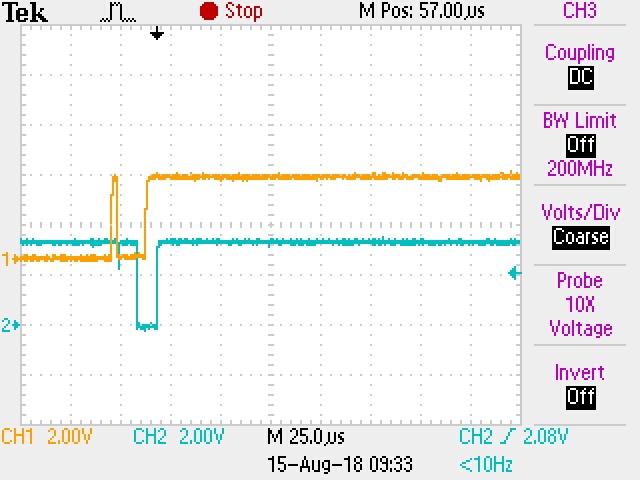

    The interesting thing about your clock stretching is at the start (this is the left side of the stretch oscope capture (below)
    this is the normal - successful - sequence. It has to raise the SCL line to then do the START pattern. Note the DES 7-bit addr is x58. the LS bit is HIGH == READ.
    the clock stretch is about 2.5 mSec
    and this is the sequence after the stretch ends (the right-hand part of the above sequence). However, the master is confused at this point, reads 0 bytes, and prints 6 bytes of trash in the buffer.
