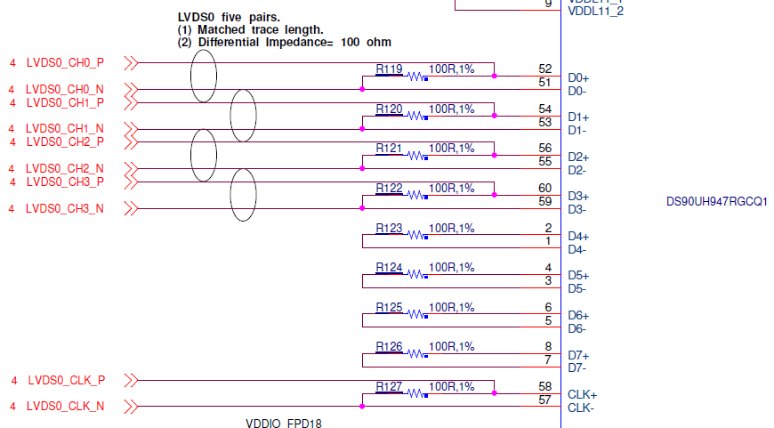

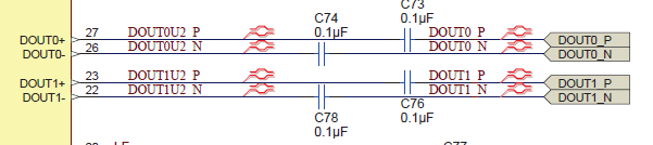

Dear support team:
My hardware configuration is to connect the LVDS signal directly to DS90UH947. Deserializer is DS90UH948, but panel has no display. Our pixel clock from SOC is "87Mhz" and the resolution is "1280x720". I originally thought that the resolution is not correct, resulting in no screen display. But when I measure the "LOCK" pin of DS90UH948, the level is Low. Do you have any suggestions about LVDS and DS90UH947?
By the way, does DS90UB947 need to define parameter in Device tree when I’m using Yocto (linux-4.14.35)?  Could you please provide some reference documents for us to test it if additional settings are required?
