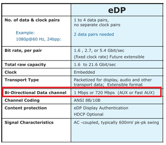

My customer want to use HD3SS213 for eDP1.4 signal. But I am not sure if HD3SS213 can support the fast AUX mode (720Mbps) or not?

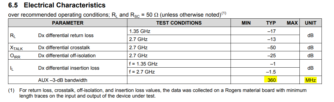

I saw it has 360 MHz bandwidth for AUX on the datasheet, but is it large enough?
