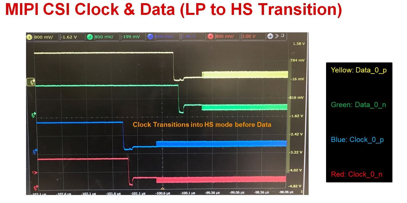

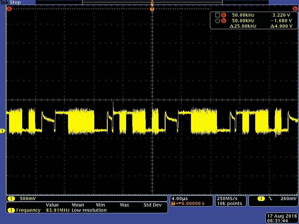

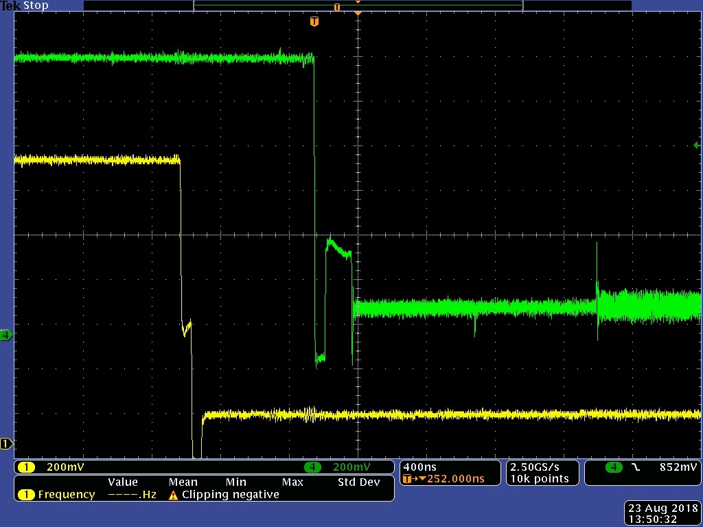

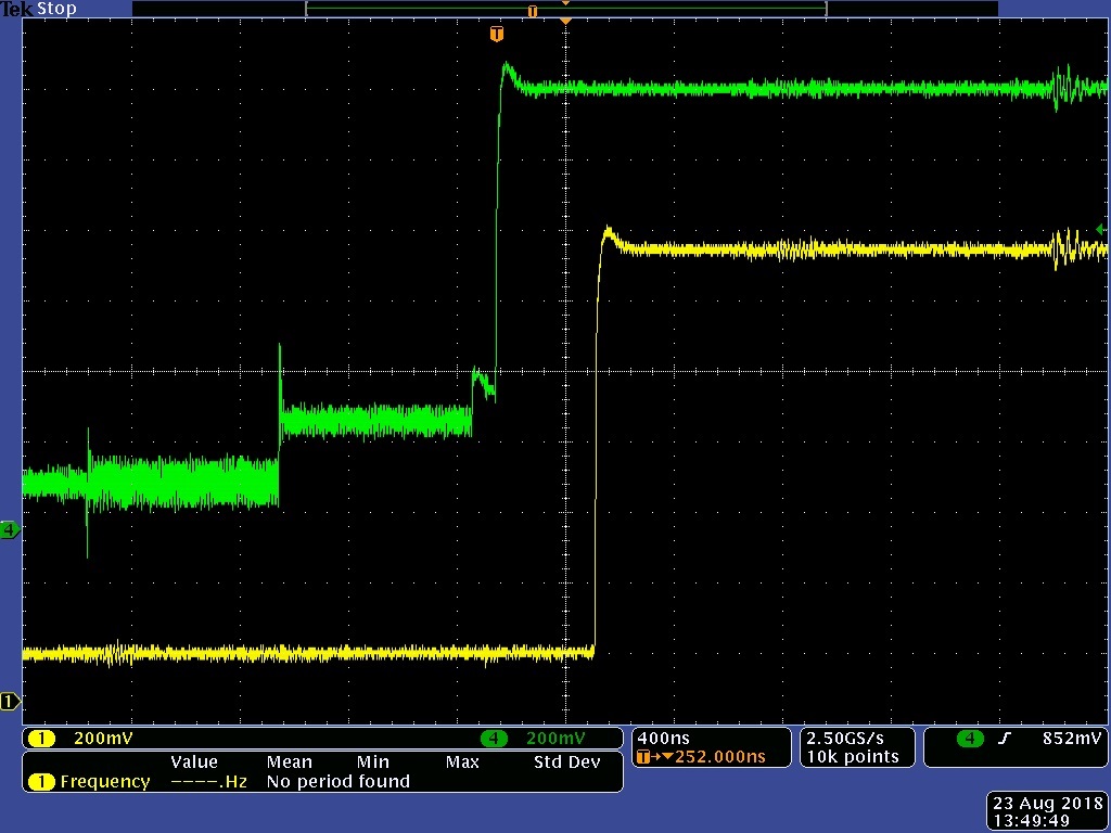

  • Hello Steven,
    I did the Test Pattern Generator test...  --> No CSI-2 clock is coming out with TPG.  I do see data with the TPG and with my sourcing it via the two 953's but neither has a clock.
    Also, I have been changing various 954 registers to see if I could get a clock but have not been able to get one.  In one experiment I changed register 0x33 from 0x03 to 0x01 which should cause the clock to stop during the LP portion of the waveform.  When I did this I did see the clock line go high during the LP portion of the waveform (as it should) but there still was no clock on the HS portion of the waveform.  At a minimum this shows that the pins are not be influenced by the pcb or the bad soldering.  Also, I have the same thing happening on two different boards.
    Also, previously the LP sections of the data signals had looked very strange as shown right below.
    You can see that they look like they are not being terminated correctly but through my experimentation with the registers I was able to fix this.  I simply removed a write to register 0x34.  I had been setting it up to do periodic skew adjust after the frame sync with a write of 0x01.  I simply took that out and the waveform now looks like the following:
    So, it looks like something internal to the part is not allowing the clock to get to the CSI-2 pins...  but the level shifting part of the logic does get there as shown by the level change when I took it out of "continuous clock mode".
    How is the clock sourced to the CSI-2 clock outputs?
    thanks,
    david

  • Hi Jiashow,
    Here are the two scope captures...
    And the LP to HS...
    thanks,
    david
  • Hi David,
    Which waveform is the clock? The green plot looks more consistent like a clock - I don't see any gaps in the waveform like what I would expect for a data plot, but the yellow plot doesn't seen to have any data in HS mode.
    It's strange that for the green plot, there's a step before HS transition and a change in amplitude in the HS mode. Are the signals terminated or just the direct output from the 954?
    Jiashow
  • Hi Jiashow,
    The yellow waveform is where the clock should be...  but there is nothing there or as you said "doesn't seem to have any data in HS mode".  I'm not sure what you mean by "gaps in the waveform".
    I agree that the signals in the data stream look strange.  They do not look this way if you look at the data that I send down from the 953's.  I posted an earlier waveform when talking about the strange rolloff of the LP sections of the data.  I will post it again so you can see it.
    In the scope shot below what you are looking at in the long packets are as follows:
    Each byte below is actually written 480 times... then you start to get the next 480 bytes..  So, first you get 480 bytes of 0xFF then 480 bytes of 0xAA... etc..
    1st long packet --> 0xFF, 0xAA, 0xFF, 0x55, 0xAA, 0x00, 0x55, 0x00.
    2nd long packet --> 0xFF, 0xFF, 0x55, 0xAA, 0x55, 0xAA, 0x00, 0x00.
    3rd long packet --> 0xFF, 0xAA, 0xFF, 0x55, 0xAA, 0x00, 0x55, 0x00.
    4th long packet --> 0xFF, 0xFF, 0x55, 0xAA, 0x55, 0xAA, 0x00, 0x00.
    repeat...  So, look at the waveforms below and you can see how the data above correlates to what you see..

  • Hi David,
    I went into the lab and looked at the plot for CLOCK and DATA on the scope:
    Both the data and clock signals you provided look different from the ones I measured. It seems like there's some output loading issue when you did your measurement, perhaps there is some termination issue as well.
    To your question regarding how clock is fed into the CSI output pins, we have the reference clock going into a PLL to derived the CSI clock output.
    Jiashow
