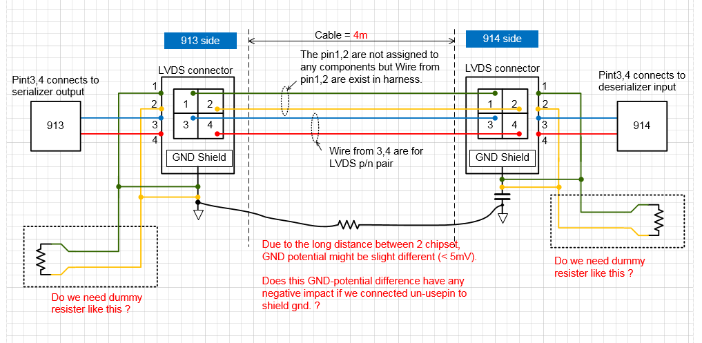

Now I'm designing PCB board with 913-914 chip set.
Connecter has 4 pin type so that 2pins use for SerDES but other 2 pins are not use.
The wire is exist all 4 pins even 2 pins are not use (pin1 and 2 in the drawing).
How should we handle these un-use 2pins ?
Put one pair (913 side) connect to GND.
(see the attached)
