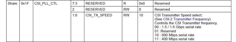

DS90UB964-Q1: Is there any description abouIs there any description about the parameters about reserved?
Part Number: DS90UB964-Q1
Dears:
Since the register is only set 0x5, CSI TX port sends out the received data. If the register is set other value, it will be in only clock lanes being valid and data lanes being completely unprocessed. Then is there any description about reserved?
Btw, Now need to operate at a 400 Mbps rate and how to configure the sensor data in the data lane that has been validated on the front end after modifying the clock Lane rate?
