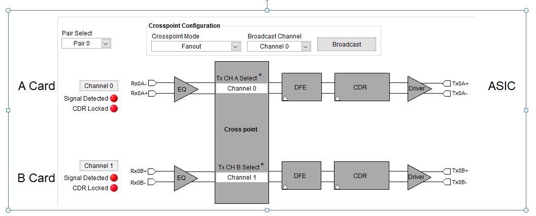

We are evaluating a new high speed crosspoint chip in our project. The type is DS280DF810 in TI.
The block diagram is as below.
  1. The data rate through Backplane is 25Gbps, can the DS280DF810 support this high data rate?
  2. One data flow from A card, the other data flow from B card, and DS280DF810 should choose from 2 data flows, then send one data to ASIC chip; the data from ASIC send to DS280DF810, DS280DF810 should broadcast data to both A card and B card; can DS280DF810 support this function?
  3. When A card data flow—crosspoint—ASIC chip channel is running, we want to switch to B card data flow—crosspoint—ASIC chip, how can we configure the DS280? and how long can DS280 complete this switch?
