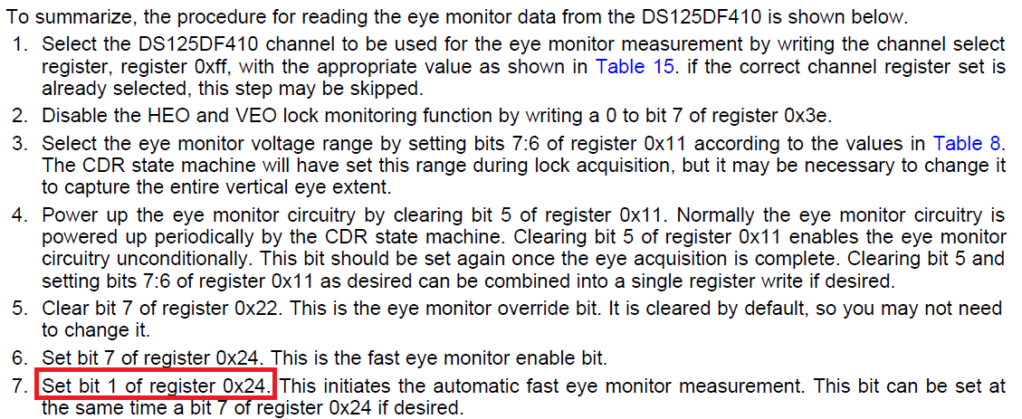

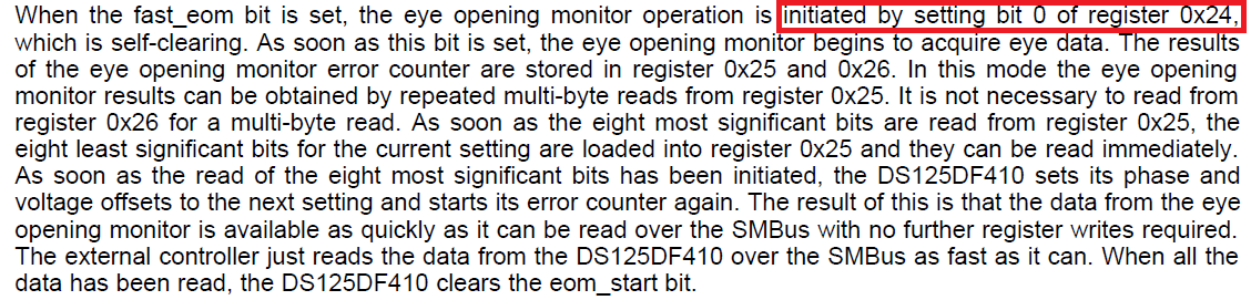

I have a question about the settings of EOM (Eye Opening Monitor).
Regarding to DS125DF410 datasheet Rev.2; Chapter 7.5.13, it looks like a different content is written.
on Page 26, it is described that the EOM operation is initiated by setting bit 0 of register 24 as below.
on the other hand, on Page 27, it is described that the fast EOM measurement is initiated by setting bit 1 of register 24 as below.
which information is correct?
