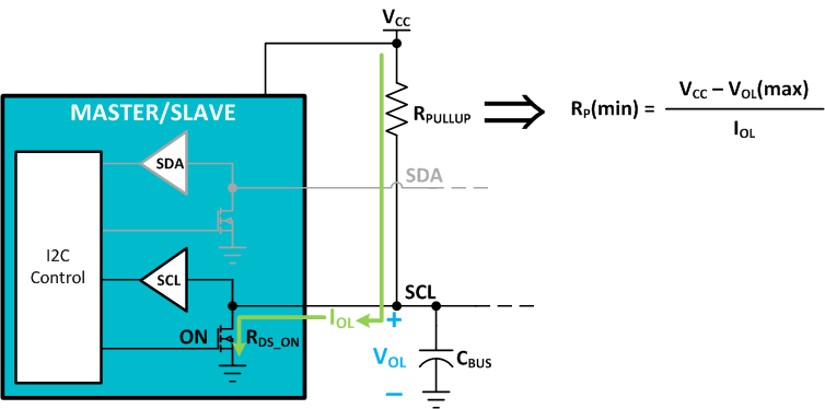

  • Hi Ma,
    We have one more query on TCA9509,
    Vol(max) of the device on the Aside port of TCA9509 is 0.18V so please let me know if you see any issue here.
    : level being driven by the device stretching the clock is lower than the "VILC" spec of the device:

  • Hello Praveen,
    As long as any device on the A side pulls the bus below VILC min then it will transfer the low to the B side.
    -Francis Houde
  • Hello Praveen,
    I just want to be explicit about saying that you may have to adjust your pullup resistor to make sure that it is below VILC.
    -Francis Houde
  • Hi Francis,
    Can you please explain how to achieve this with Pull-up resistors ?
    As you know, Vol(max) of device on A side is 180 mV and the VILC(min) is 110mV. As per Datasheet, Vol should be less than VILC (110mV).
    Please consider this as priority.
    Praveen GD
  • Hello Praveen,
    You will have to find out what the strength (on resistance or Rdson) of the pull-down FET of your slave or master that is attached to the side with the static voltage offset.  Usually this is done by taking VOL max and dividing that by the defined IOL.  This is essentially the max Rdson of the pull down FET.  Then you just do a simple resistor divider equation where you have the mid voltage as the voltage seen for Vilc.  Then back calculate what the lowest pullup resistor value can be to maintain that Vilc.  It is similar to how Rp(mi) is calculated but instead of using VOL(max) you use Vilc.
    Here is the app note for the pullup resistor calculations:
    I2C Bus Pullup Resistor Calculations
    Remember pullup values pertain to both SCL and SDA.
    Let me know if this isn't clear.
    -Francis
