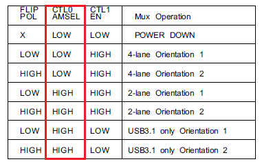

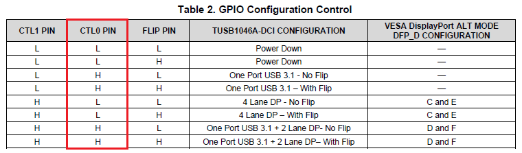

  • Hi Eric-san,
    TUSB1046 EVM shows GPIO0 (=AMSEL) is direct connected to CTL0.
    However I think CTL0 and AMSEL isn't match as the following.
    For example, CTL0 should be set "Low" in 4 Lane DP, however AMSEL is set "1" in 4 Lane DP.
    - TUSB1046 datasheet
    - GPIO Events of TPS6598x
    http://www.tij.co.jp/jp/lit/an/slva838/slva838.pdf
    How should we set GPIO0 event when GPIO0 is direct connected to CTL0?
    Yaita
  • Hi Yaita-san,
    I understand your question better now. From the looks of it, CTL1 should be set to DisplayPort Event, CTL0 should be set to USB3 Event, and FLIP should be set to Cable Orientation. Also make sure that the HPD pin is connected properly, I did not see it on your list.

  • Hi Eric-san,
    Yes! I have thought as you referred above.
    I assigned GPIO0 to USB3 Event with my TPS65986EVM however GPIO0 showed "Low (0V)" when connecting USB3.1 Hub(BSH4U105C1BK) although enabling pull-up resisor as the following referred.
    I also confirmed USB3 Connection showed "disconnected" in Utility Tool in this case.
    On the other hand, GPIO0 showed "High" when connecting another USB3.1 Hub (U3HC-DC03BBK).
    I also confirmed USB3 Connection showed "connected" in Utility Tool in this case.
    The result shows different between USB3.1 Hub(BSH4U105C1BK) and USB3.1 Hub (U3HC-DC03BBK).
    What do you think about the difference?
    I believe USB3.1 Hub(BSH4U105C1BK) has a problem however want to have your comments.
    Yaita

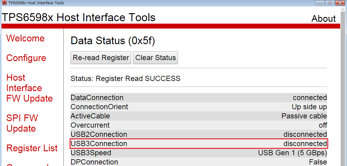

  • Hi Eric-san,
    Thank you for your reply.
    In case connecting BSH4U105C1BK (USB Type-C Hub that does not support PD) with TPS65986EVM, it shows USB3Connection is "disconnected" as the following.
    Do you know how TPS65986 does detect USB3Connection?
    If BSH4U105C1BK does not have the correct CC advertisement we should contact vendor of BSH4U105C1BK however I can't explain what is the issue that resides in BSH4U105C1BK.

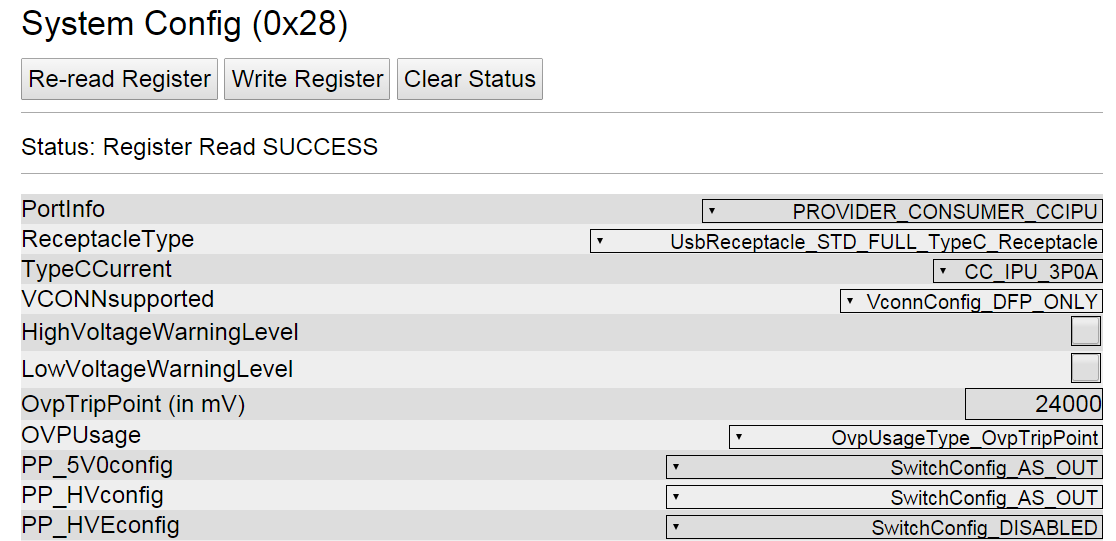

  • Hi Yaita-san,
    We would look at the CC pull-up and determine if it is a USB3 or USB2 device. Typically for USB Type-C only, we would always enable USB2 and USB3 connection until we see that they are not supported from the connected device. I would suggest checking the System Configuration (0x28) register to see if you have USB2 and USB3 support both enabled.

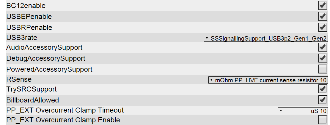

  • Hi Eric-san,
    I confirmed System Config (0x28) as the following.
    "Receptacle Type" shows "UsbReceptacle_STD_FULL_TypeC_Receptacle" and "USB3Rate" shows "SSSignallingSupport_USB3p2_Gen1_Gen2", so I believe USB2 and USB3 are set to supported.
    However "USB3Connection" and "USB2Connection" of Data Status (0x5f) shows both "disconnected" when connecting BSH4U105C1BK.
    Please let me know if there is another register I should check.
    Yaita
  • Hi Yaita-san,
    I would suggest checking with the manufacturer of BSH4U105C1BK as it seems that device is reporting USB2 and USB3 are not supported.
