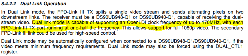

I am trying to determine the proper PCLK setting when using the 947 in dual lane mode. The display I am driving has the following specs:
H width: 1920
H Blanking: 160
V Height: 1200
V Blanking: 16
Refresh Rate: 60fps
Using those specs, I calculate a PCLK of 151.76MHz. But since I am using dual lane, do I halve the PCLK to 75.88MHz?
The datasheet is unclear in the dual lane most section.. "... with each FPD-Link III TX port running at one-half the frequency"
Does this mean I need to halve the frequency? Or does the part do that on its own and I should feed it 151.76MHz?

    You need to feed it 151.76 MHz. In Dual Link Mode, each FPD-Link III would run at PCLK/2.

    Thank you for the clarification. So the 947 changes the clock speed from 151.76MHz at the input to 75.88MHz on each FPD-Link, correct?

    Sorry for the delay. Yes, the output pixel clock (PCLK) would be 151.76 MHz. Depending on how the 948 is configured, the oLDI clock would either match the PCLK (single oLDI ouput) or remain split at PCLK/2 (dual oLDI outputs). See Figure 31 (Datapath Configurations) in the UB948 datasheet.

    Below  is a table that summarizes the relationship between PCLK, OLDI input clock, and FPD3 clock for each possible permutation of OLDI input and FPD3 output modes for the 947.  This should answer all your questions.
    Let me know if further clarification is needed.
    Davor
    OLDI Input Mode OLDI Input CLock Equivalent PCLK FPD3 Output Mode FPD3 Port 0 Clock FPD3 Port1 Clock
    Dual OLDI Input 12.5 MHz - 48 MHz 25 MHz - 96 PCLK Single FPD3 Output 25 MHz to 96 MHz N/A
    Dual OLDI Input 25 MHz - 85 MHz 50 MHz - 170 MHz Dual FPD3 Output 25 MHz to 85 MHz 25 MHz to 85 MHz
    Single OLDI Input 25 MHz - 96 MHz 25 MHz - 96 MHz Single FPD3 Output 25 MHz - 96 MHz N/A
    Single OLDI Input 25 MHz - 170 MHz 25 MHz - 170 MHz Dual FPD3 Output 25 MHz to 85 MHz 25 MHz to 85 MHz
