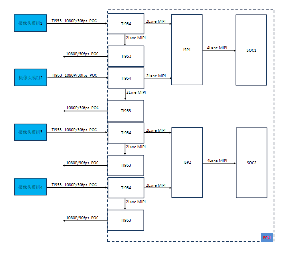

Hi all,
could you help me check the  application design of DS90ub953&DS90UB954 is reasonable or not, and the  Block follows as below(4 1080P@30fps input & 41080P@30fps bypass output ):
if you have good solution also can show me !!

    A couple of clarifying questions:
    -Are you configuring 954 in replicate mode, so that an image is forwarded to ISP and a copy of the same image to the adjacent 953 on the ECU board?
    -What are you driving with the 953 FPD-Link III outputs going off the ECU?
    Davor
  • Hello-
    -Are you configuring 954 in replicate mode, so that an image is forwarded to ISP and a copy of the same image is forwarded to the adjacent 953 on the ECU board?
