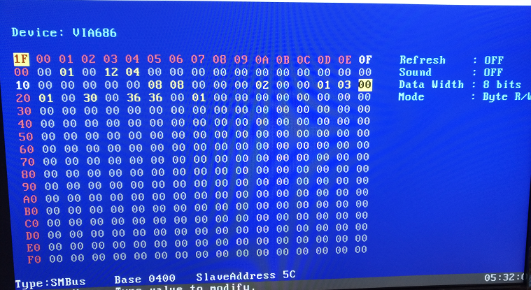

SN75DP130: Can't config reg 1FH through I2C
Part Number: SN75DP130
Take 00103h for instance, 1C,1D,1E is config as 00,01,03, then to modify the values of 1F bit 1:0 and 4:3, but the value of 1F is keep 00 whatever input.
Now config I2C offset address as following:
1CH=00H 1DH=01H 1EH=03H 04H=00H, and 1FH keeps 00.
The schematic and config datasheet are attached.slla349.pdf
2248.DP Re-driver.pdf
  • Chen
    Would you please write to and read from address 0x20h bit 0, bit 0 is BIT_INVERT, which means the value read is in the inverse of that written? I want to make sure i2c is working properly.
    You should write to 0x04h first to disable link training and then try to overwrite the DPCD register.
    Also as I was pointed out in my other e2e post, given that DP130 is connected to both source and sink DP connector and if the cable will be changed between source and sink, DP130 is not best suited for this particular application.
    David
  • When write 0 to 0x20h bit 0,the value read is 1,
    write 0 to 0x20h bit 1,the value read is 0
  • Yan
    It looks like the I2C is working, are you following the same sequence that is the slla349.pdf app note? Also, when you change the TX VOD level, are you seeing the waveform change on the scope?
