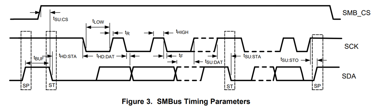

Our customer used DS32EL0124 for FPGA high speed data transmission but when he try to follow  DS32EL0124 DS page17 "reading a register issue description" to programming their FPGA code but  slave can't reply corresponding register while he write.
The DS of reading a register issue description as below:
1. The Host (Master) selects the device by driving its SMBus Chip Select (SMB_CS) signal HIGH. 2. The Host drives a START condition, the 7-bit SMBus address, and a “0” indicating a WRITE. 3. The Device (Slave) drives the ACK bit (“0”). 4. The Host drives the 8-bit Register Address. 5. The Device drives an ACK bit (“0”). 6. The Host drives a START condition. 7. The Host drives the 7-bit SMBus Address, and a “1” indicating a READ. 8. The Device drives an ACK bit “0”. 9. The Device drives the 8-bit data value (register contents). 10. The Host drives a NACK bit “1”indicating end of the READ transfer. 11. The Host drives a STOP condition. 12. The Host de-selects the device by driving its SMBus CS signal Low
Could you please share the DS32EL0124 SMBus clock waveform which follow the description as above.
And customer can follow the waveform to programming  their FPGA code to generate right communication data clock.
Thank you.

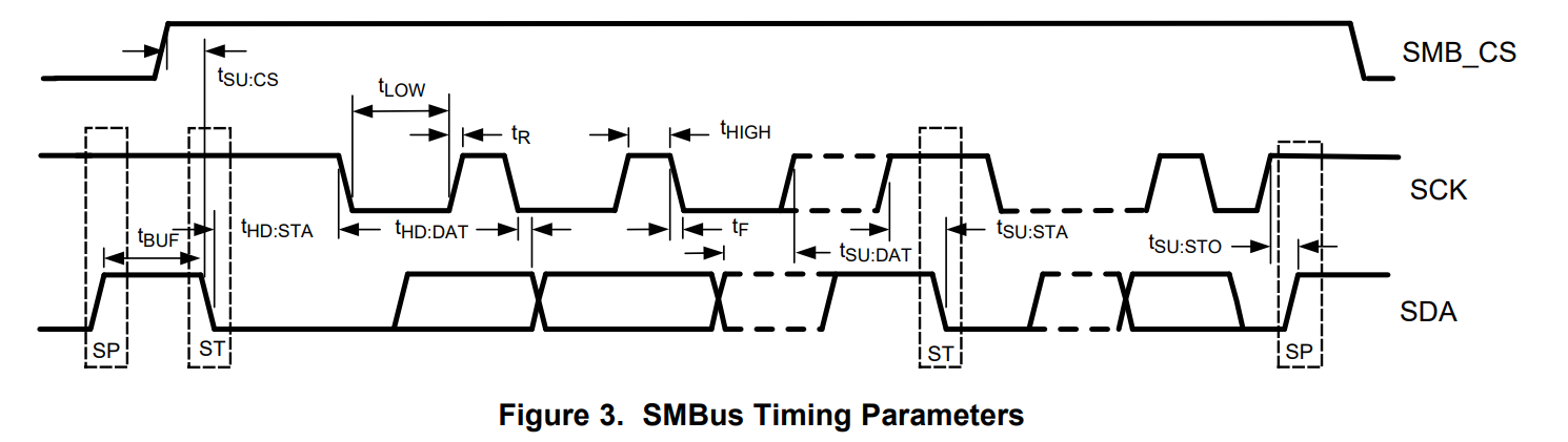

    All values timing values and voltage levels for SMBus are located in datasheet on (pg. 6). Please see image below or waveform and corresponding timing parameters from datasheet.
    Customer encounter issue is FPGA(Mater)/DS32EL0124(Slave) communication issue and need follow DS32EL0124 DS page17 “reading a register” step1~12 to set.
    And the question point is step4: The Host drives the 8-bit Register Address(FPGA) and step5: The Device drives an ACK bit (“0”) from DS32EL0124 but description didn’t mention the timing setting.
    Simply said, if we can provide step1~ step12 description to waveform(even drawing by hand) for Kuo-Wei bench mark as well.
    www.ti.com/.../ds32el0124.pdf
    Ps1. Altera has SMBus IP but can’t communication with DS32EL0124.
    Ps2. Customer tried to coding SMBus waveform depend on DS page9 Figure 3 which same as Altera SMBus IP waveform.
    Ps3. Also, double confirm the VIH/VIL are meet SMBus DS spec.
    Warm Regards,
    Lin
  • Lin,
    I will work to provide the waveform on this thread, unfortunately we do not have these on hand and the waveform will need to be generated. In the meantime, could you answer the following questions:
    • Can you write to DS32EL0124? If so, are you seeing ACK commands sent by slave?
    • What slave address are you using to access DS32EL0124? Should be the 7 bit address corresponding to B0'h
    The ACK sent by the slave device should be seen by the master every 9th clock cycle indicating a byte, sent by SMbus master, was received (timing for step 5). SMBus master should not be controlling the data line at this time.
    Also in step 4 (as referenced below, see green highlight) the register address should be the desired DS32EL0124 register address.
