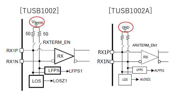

We understand that Rx termination circuit of TUSB1002 and TUSB1002A are different.
We would like to know the reason why this circuit was changed to.
Could you please let us know if you have any information?
Kanemaru
  • Kanemaru
    The RX termination structure change from TUSB1002 to TUSB1002A is to provide better compatibility support with some USB3 devices on the market that do not comply to the USB common mode voltage requirement in the spec.

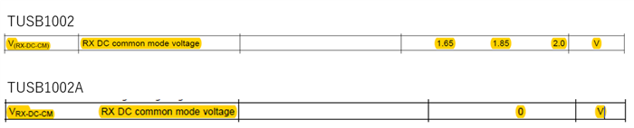

  • Hi David-san,
    I have additional question.
    I understand that some USB3 devices on the market can’t comply with the USB common mode voltage (1.65V(min), 1.85V(typ), 2.0V(max)).
    Therefore, you changed the Rx termination circuit and added option 330nF and R15 and R16.
    Is my understanding correct?
    [TUSB1002 and TUSB1002A Rx common mode voltage]
    [TUSB1002A datasheet]
    330 nF A/C coupling capacitors along with 220k resistors are placed on the RX2P and RX2N.
    Inclusion of these 330nF capacitors and 220k resistors is optional but highly recommended. If not implemented,
    then RX2P/N should be DC-coupled to the USB receptacle.
    Kanemaru
  • Hideto-san
    Your understanding is correct.
