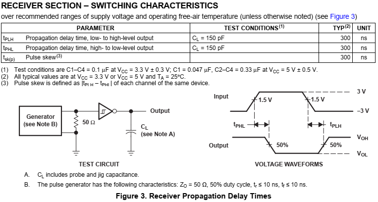

There is no maximum specification of propagation delays.
Does this mean that we possibly have the device with large propagation delay which does exceed the standards?
Do you have any of indication of maximum value?
Also, is there the specification of propagation delay in the standard?
