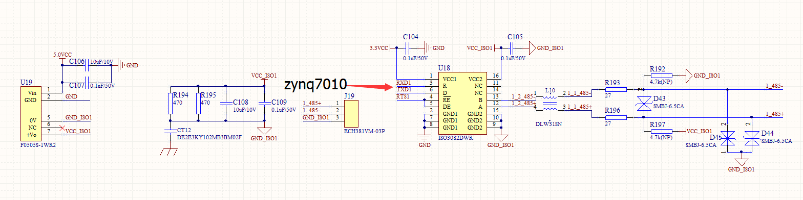

as you see  above,above is my 485 circuit ,the cpu is zynq7010.When doing Radiated radio-frequency electromagnetic field immunity test on 485.we find that Communication between two 485 nodes is interrupted when the frequency is between 2M and 3Mhz,After this frequency, the communication returns to normal..485 communication speed is 9600bps。can somebody tell me why,is there some bug with my circuit?

    Radiations can be picked up by various components on the PCB like the magnetics, traces and others. A good practice make a system immune to such noise is to bandwidth limit all the inputs of a device using RC filters such that datarates are not affected. I am not sure if the communication data is corrupted at the CPU, Side1 of ISO3082 or on the RS-485 bus. This has to be found out by experiments.
    The RS-485 bus is differential and is generally immune to common-mode noise. It is also worthwhile to remove the common-mode choke L10 on RS-485 bus and test to see if that makes any difference. Let me know, thanks.

  • my device requires the testing to be conducted for frequencies from 0~80M,the radiation levels is 10V/m.By experiments, we found 485 receive and transmit are not normal at 2.7M OR 3.7M
  • You are not nice, you don’t answer the questions I sent.Finally, after an experiment, it was found that a 120 ohm resistor was connected to the terminal, and the problem was solved.So I want to ask a question, is there a chip with a terminal impedance of 120 ohms and compatible with the ISO3082 chip?
    I am very sorry that I couldn't come back to you with more inputs to resolve the issue you were facing and I am glad to know that you could meet the radiated immunity requirement by placing a termination resistor of 120Ω on RS-485 bus.
    Regarding your question on 120Ω terminal impedance, did you mean to say that you are looking for a device with 120Ω of terminal impedance integrated? Terminal resistors are typically not integrated into devices and they are placement on the bus is quite dependent on connection topology.
