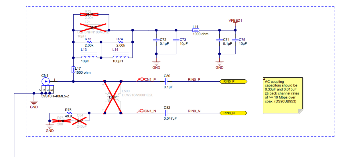

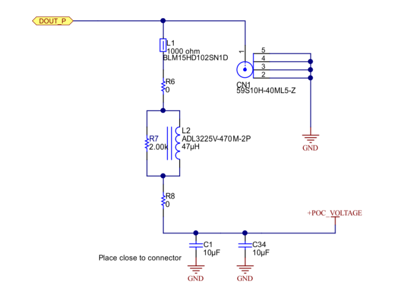

These are the reference design we are referring for
TI934
http://www.ti.com/lit/ug/snlu220/snlu220.pdf
TI933
http://www.ti.com/lit/ug/snlu210b/snlu210b.pdf
But  in the above two designs there is a mismatch in the filter design. Please confirm on which is the right way .
TI934-Filter
TI933 -Filter
    The Power over coax filter shown on DS90UB934-Q1 provides higher impedance across wider frequency range and also can be acceptable for DS90UB933-Q1. For the image sensor/DS90UB933-Q1 side there is alternative filter shown for smaller size.
    Please refer to and follow recommended application diagram in the datasheets.
