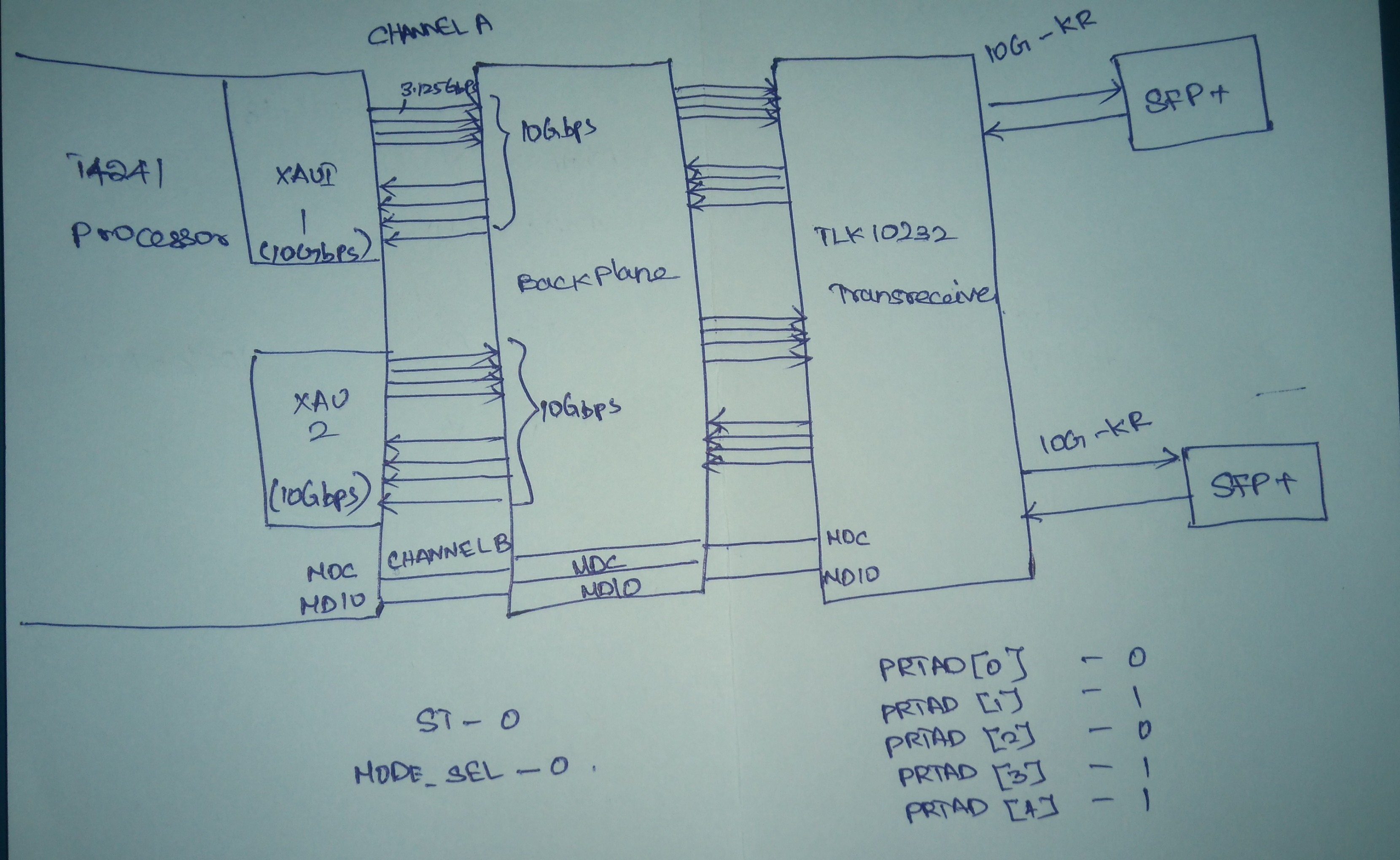

             We are facing a serious issue with respect to TLK10232. We made a customized design with T4240 Processor along with the TLK10232. We are using U-Boot version - 2016.01 and kernel version - 4.1.8 .  TLK10232 mdc and mdio are connected to the T4240 Processor.  Input reference clock is 156.25MHz. Pins That are hardwired,
PRTAD[4:0] - 11010,
ST - 0 and
MODE_SEL - 0
How can we able to perform the read and write operation on TLK10232 to achieve 10G . Bulk Production is on hold due to this issue. Kindly Provide some idea to resolve this issue.

                 We are trying to access the TLK10232 via mdio in U-Boot. what is the command to access the register. I have tried as bellow,
    mii read 0x1a 0 - to read Channel A Vendor specific Device register (Device address - 0x1a and register 0)
    mii read 0x1A 0x1E  - to read Channel A Vendor specific Device register (Device address - 0x1a and register 0x1E).
    Whether the accessing device address and the procedure is correct ?
    What is the device address to access the TLK10232 ?
    Thanks in advance.
    Avinash N
  • Hello Avinash,
    Please see PRTAD[4:0] pin description in the datasheet, page 8.
    Yaser
