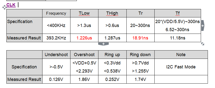

We have test issue for tscl of TCA9544APWR.
Our measurement is 1.22us, it's lower than data spec 1.3us.
We would like to know this value is control by 9544? or PCH?
Could you share experience for us how to fix it?
