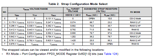

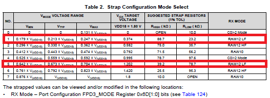

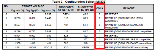

According to the DS90UB964-Q1 datasheet, we can choice the COAX or STP by bootstrap of mode select pin.
However, I can't find same description in DS90UB962-Q1 datasheet.
We don't need to care this settings at DS90UB962-Q1?
