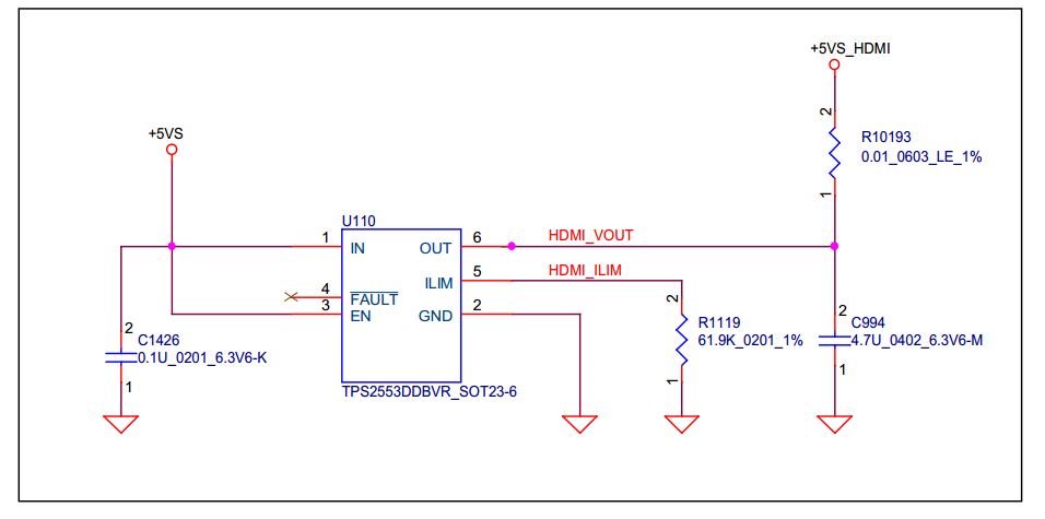

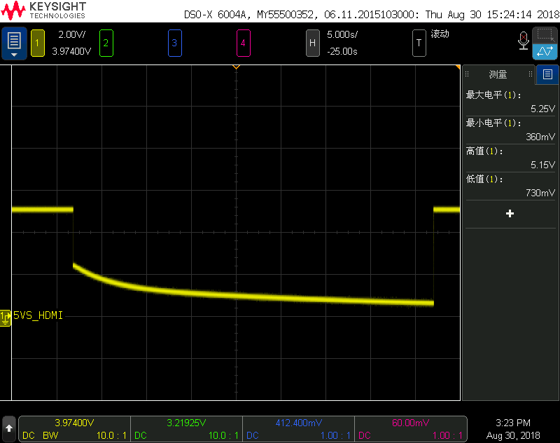

Does TPS2553 has discharge feature? Customer found that the discharge time is about 30s. Is it normal?
Below is schemaitc:
Below is waveforms:
+5VS:
+5VS_HDMI:
  • Hi, Nic,
    This part doesn't have discharge function. The waveform should be normal.
