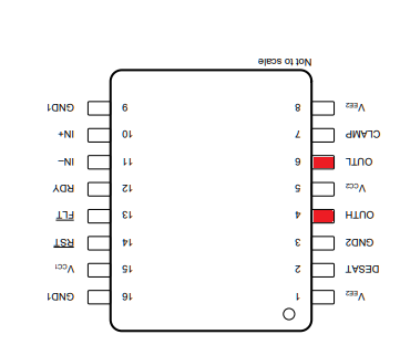

Hi Team,
     Is ISO5452 PIN2PIN of ADuM4135? I found they are different.
The Positive gate drive voltage output and Negative gate drive voltage output is exchanged.

    The ISO545x family is the TI equivalent, it is a direct replacement in functionality, parametrics but different in pinout as you pointed out which, with slight board rework can be solved.

    Sorry for the confusion, I meant a small modification of schematic/PCB board.
    This family of devices is the best candidate for replacing this competitor part.
    Let us know if you need help reviewing your schematics and/or how to best utilize our part in your application.

    After further looking into this, ISO5452 is actually be used as a direct replacement for the competitor part by simply maintaining the same gate resistor values between OUTH and OUTL.
