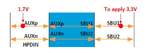

Hi Team,
Currently, our customer is evaluating an internal MUX of TUSB1044.
If they apply 3.3V to SBU1 pin, AUXp voltage is around 1.7V.
Does MUX have a cause of voltage drop?
Of cause, they understand that this usage is unique.
However, they would like to know this cause.

    Is the customer configuring TUSB1044 using FLIP/CTL0/CTL1 in GPIO mode or FLIPSEL/CTLSEL in I2C mode? If not, then the switch between AUX and SBU is open and 1.7V on AUX probably is the leakage voltage from SBU.

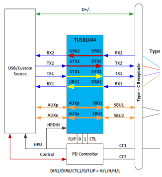

    Each pin are set by GPIO
    DIR1:H
    DIR0:L
    CTL1:H
    CTL0:H
    FLIP:L

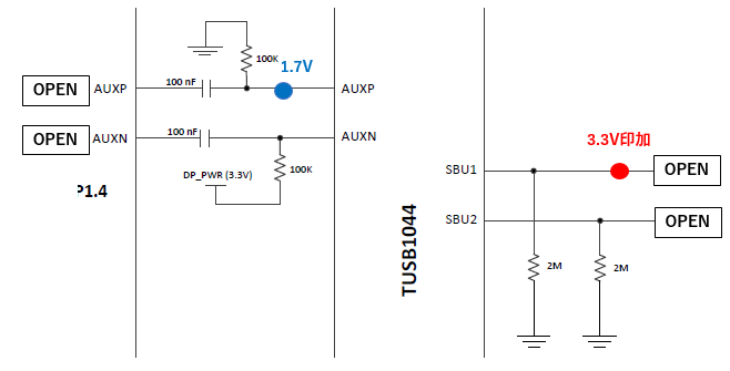

    And, their measurement environment is as follows.
    Could you please let us know if you have any information and concern?

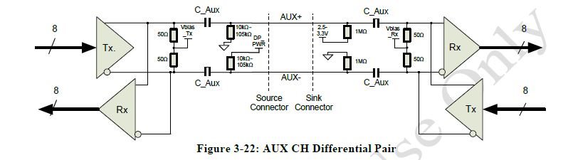

    TUSB1044 configuration is correct, but the test setup is not valid. Per the DisplayPort CTS spec, the DUT shall be connected to a circuit equivalent to the respective counterpart of Figure 3-22 of the DP standard. For example, if the DUT is a Source, the test load shall be equivalent to the Sink portion of Figure 3-22. This equivalent circuit shall include any loading of the test equipment.
    Below is Figure 3-22 copied from DP spec.
    So you can not directly apply 3.3V to SBU1.

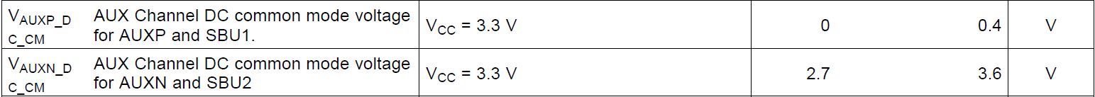

  • Hideto-san
    The common mode voltage for SBU1 is min of 0 and max of 0.4V. Applying 3.3V directly onto SBU1 exceeds this common mode voltage requirement, and place the mux into an non proper working state. I can't say whether 1.7V is the correct behavior of this non working state. But again, 3.3V should not be directly applied on SBU1.

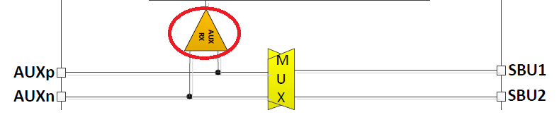

    [Q1]
    We understand that if a normal MUX, 3.3V of SBU1 is observed on AUXp but they can’ observed 3.3V on AUXp.
    Therefore, we guess that AUX RX affects 3.3V.
    Is my understanding correct?
    If yes, could you please let us know a detail reason (information)?
    If no, could you please let us know other cause?

    [Q3]
    I understand that if Type-C receptacle is flipped, AUX channel DC common mode voltage is the following.
    -0V to 0.4V @ Vcc=3.3V for AUXp and SBU2.
    -2.7V to 3.6V @ Vcc=3.3V for AUXn and SBU1.
